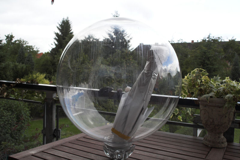

Do you know the KeyKeg beer barrels?
Look at this:
We´re trying to build rockets with these barrels at the moment.
Greetings
